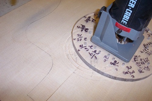

I have a dremel that i used for binding channels on my first and it was such a nightmare that i put it away in it's case, did not even consider doing a rosette on no 2 with it, i bought the Porter Cable 7310 Lam trimmer and using this jig, it went much easier for the rosette and i'm using another jig for the binding channel.
I do my rosette a la Mario's with a piece of plexiglass that i attach at the bottom of the dremel and decide where i want the diameters to be pivoting from, here's a pic
Serge Poirier38933.6810069444

Serge,
I own the Porter Cable 7310. It is a great tool. I really like that base you have on it. I'm going to have to make one of those. That must save a ton of tine in set up.
Do the dimensions on your base indicate center to center for the cutter and the dowel, or is there compensation for the cutter and/or dowel.

Steve, sorry for the time i made you wait, i'm still at work!
Yes, i measured from the center of the cutter to the center of the dowel, but one could make measurements with compensation in mind yeah.
This jig was inspired by Mike Tobey's jig, purchased at Lee Valley Tools, here's a link

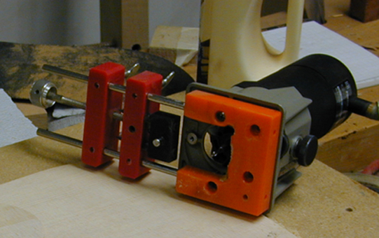

PostPosted: Fri Aug 04, 2006 11:53 pm

Been posted before, but here is my circle cutter - infinitely variable and locks with the screw knobs...
built off the idea of the Schneider cutter that LMI sold.

You have to remember - this has a 1/4-20 thread, so every 1/4 turn is 12.5 thou - you can get pretty darn accurate with that. If a purf line it fitting really tight, just a touch on the screw and another go round and it fits beautifully.
